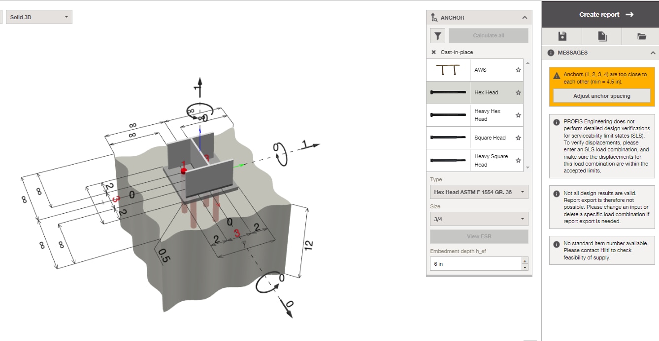

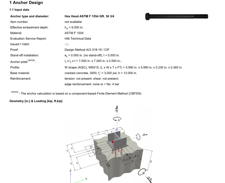

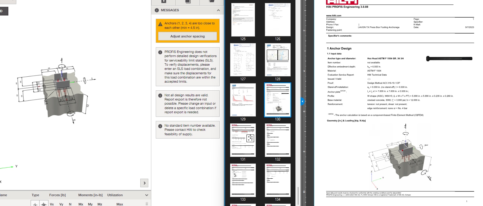

PLease see the atttached snip from before showing i could run it and now i cannot but same geometry and everything.
Minimum anchor spacings,cast in anchor bolt

Hi Adam,
In order to further assist, can you please send your two ".pe" files to hnatechnicalservices@hilti.com? This will allow us to analyze the files and determine if there are any differences.
