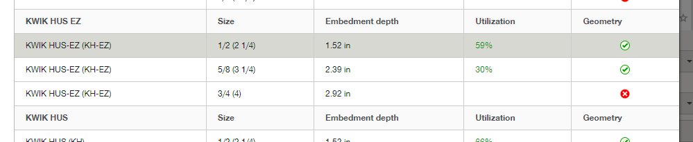

I want to use 1/4" KWIK HUS-EZ (KH-EZ) but only 1/2 5/8 & 3/4 are available in program. Why is this?
1/4 hilti kwik HUS-EZ,isn't available,1/4",LESS THAN 1/2 INCH

It may be due to the drilling method you have selected in your design. If the drilling type selected is core drilled, 1/4" KH-EZ is no longer an option. Selecting hammer drilled may make the 1/4" option available.
