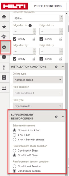

Where is the tab for reinforcement in concrete (supplementary bars) in Profis

Hi Oz,
The Supplementary Reinforcement options are found in the base material tab. See image attached.
