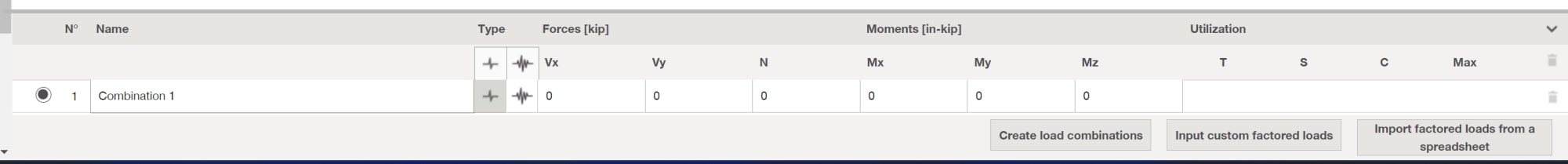

Hello, while assigning loads to the pier base plate design there is this combination 1; I wanted to know that is it a factored or not?

Hi Junaid,
Factored loads must be entered into Combination 1 in PROFIS Engineering. If you are using a premium version of the software, the "Create load combinations" button will allow you to create custom factored loads based on the equations of IBC.
