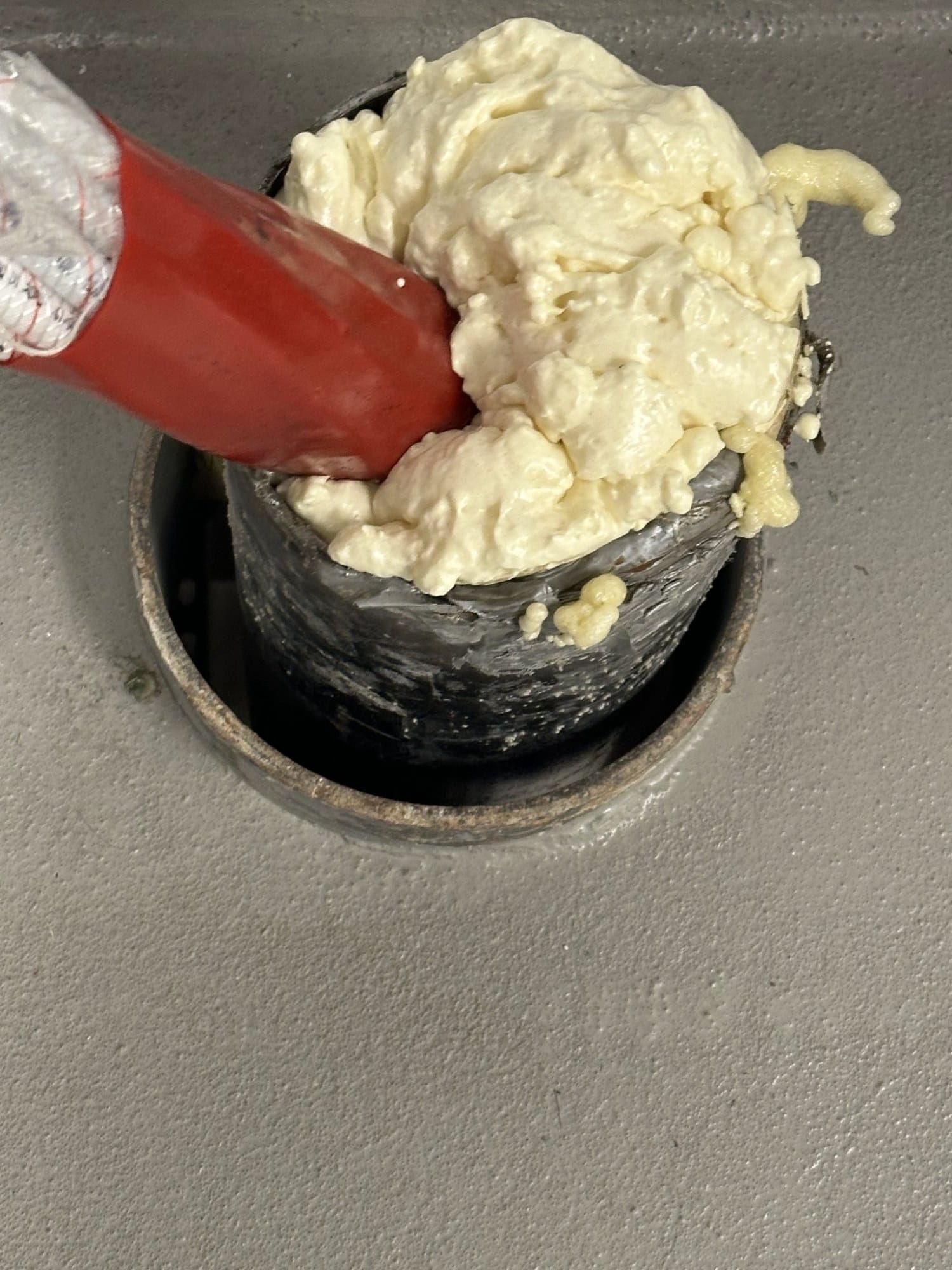

What fire stopping should be used
we have a pipe with cola tubing in our new hospital kitchen that was incorrectly caulked by the soda vendor. What options do we have for this piping and surrounding it for proper fire stopping
Fire caulk,6 in pipe

Jennifer,
Thank you for reaching out to the Hilti Fire Protection Design Team to assist you with your firestop engineering needs.
We have a couple of systems for beverage line sets, which I have attached. If these systems do not meet your needs, then we can address your application through an Engineering Judgment which will be a custom detail showing your exact application with the firestop components required to maintain the stated ratings.
