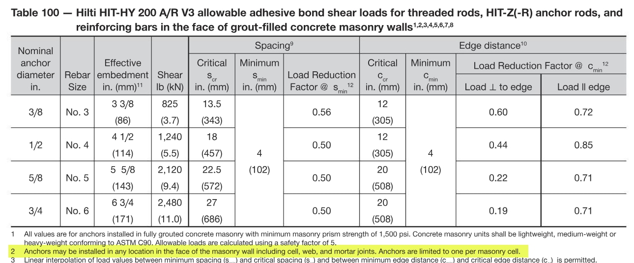

Using PROFIS to design anchor for masonry solid core. Specified HY 200-A epoxy with A36 threaded rod. Why is there an error message about a limit of one (1) anchor per CMU core? Where is that specified in the Hilti literature/technical guide? Assuming this has to do with the structural integrity of the CMU after the hammer drilling?

If you are designing according to ASD, this information can be found in Hilti's Anchor Fastening Product Technical Guide on page 99 in Footnote 2 of Table 100. If you have any further questions, please feel free to email us at hnatechnicalservices@hilti.com.
