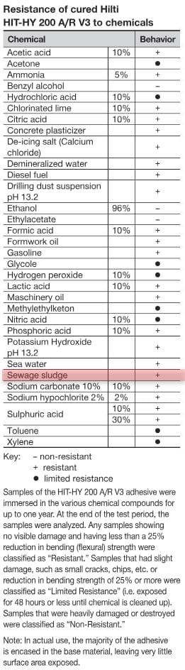

Both HIT-HY 200 V3 and HIT-RE 500 V3 may be exposed to submerged conditions when fully cured, but please note that only HIT-RE 500 V3 may be installed in a submerged condition.
Also, cured HIT-HY 200 V3 is resistant to sewage sludge, per the chemical resistance chart on page 104 of the Anchor Fastening Technical Guide.
