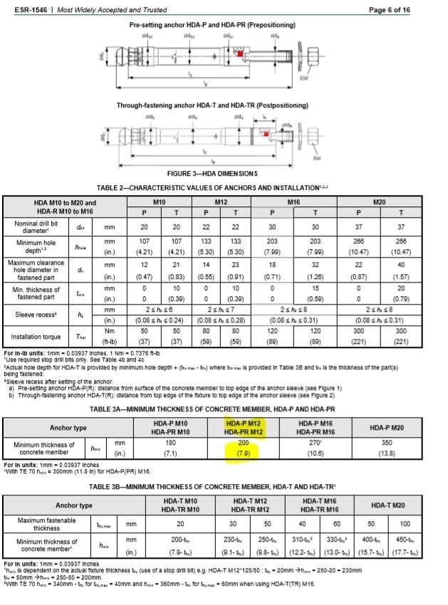

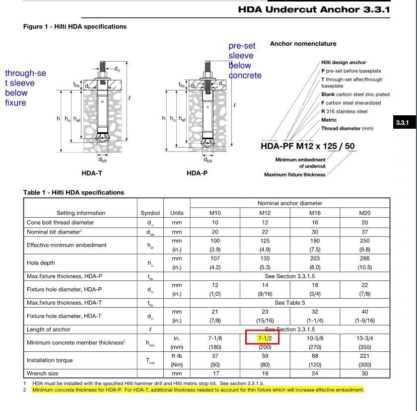

We found undercut 's minimum required concrete thickness is inconsistent between product specification and ICC-ESR report. For M12 HDA-PR, specification shows minimum concrete thickness 7.5in while ICC-ESR show 7.9in. Which one is correct? Please refer to attachment.

Hi Shawn,
Sorry for the confusion, however, please use the values listed in the ICC-ES ESR. The Hilti technical data will be corrected in the next revision.
