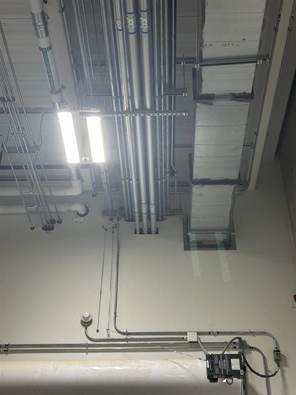

I am in need of a UL for a (3) conduit penetration through a 2hr gypsum wall. (2) conduits are 4 in., (1) is 2 in. Similar to W-L-8079 except allows for 4 in EMT.

Hello, WL 1408 may work for your application if you are within the annular space requirements. If it does not work for you please submit an Engineering Judgement (EJ) on Hilti Construction Platform. Please see below on how to submit the EJ.
