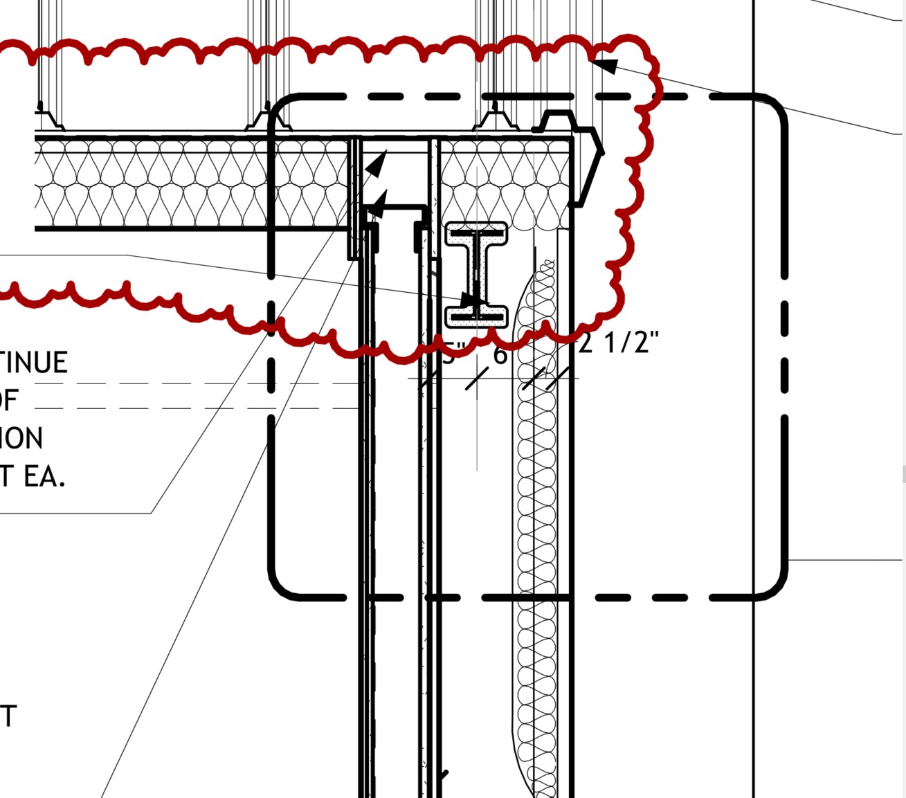

We need to apply fireproofing at an structural frame of a PEMB. I am looking for an UL detail for a beam below a metal roof structure. All the Hilti listed UL numbers for this product are to a concrete slab.

Hello Hilti does not have any UL listed systems that would match your condition. We can look at providing you an Engineering Judgement (EJ) for this application. Please see below on how to submit for an EJ.
