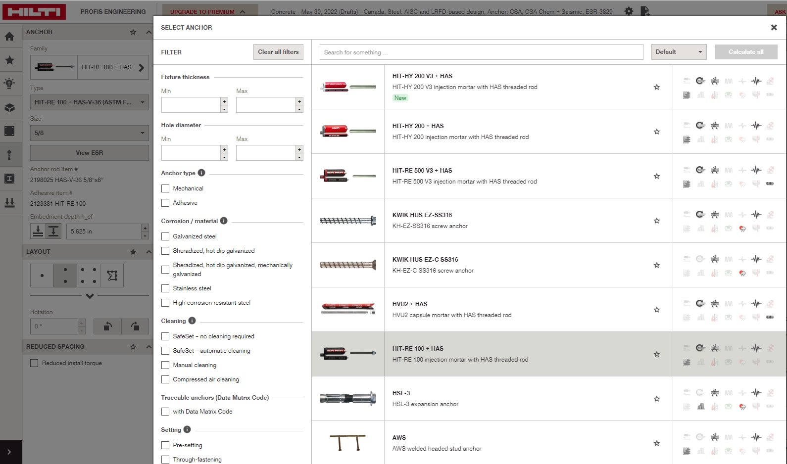

Hi,
I'm working on a project in PROFIS and the type of anchor I want doesn't seem to be available.
I would like to use a chemical anchor type HIT-HY-100 but I only see the HIT-RE-100 or the HIT-HY-200 in PROFIS. Is there a reason why I dont have the option to do the simulation with this anchor (HIT-HY-100)?
Thank you in advance,
Joel

Hi Joel,
HIT-HY 100 may not be an option in PROFIS Engineering if CBFEM is selected under the anchor base plate advanced calculation type. HIT-HY 100 may become available if a rigid base plate calculation type is selected. For further technical assistance please contact hnatechnicalservices@hilti.com.
Thank you,
Emily
