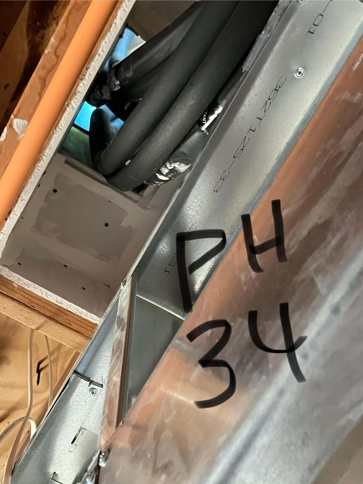

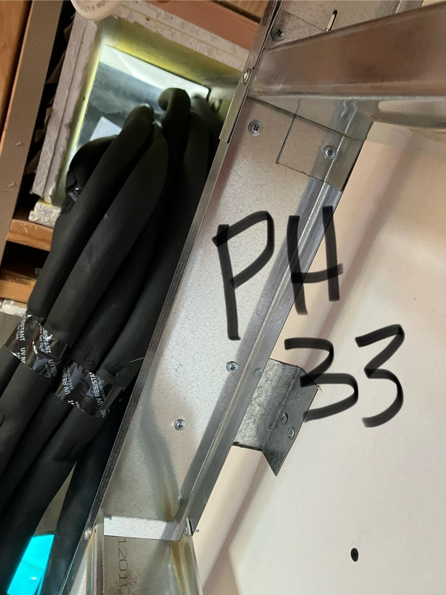

in a single family residence on the top floor the line sets go through the ceiling through a square opening, referred to as the dog house, my question is , does that opening need to be fire caulked?

Hello Joseph,
We can look at this in an Engineering Judgement (EJ) - see below on how to submit for an EJ. However, Hilti is not able to make the determination if/where you need firestopping. You would need to talk to the architect and/or the local AHJ.
Thank you,
Chase Hellan
Sr. Fire Protection Engineer
