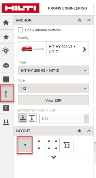

Is there a way to design or check capacity of a single anchor bolt in Profis?

Hi Alan,
There is an option to design with a single anchor in PROFIS Engineering. To select this option, go to the anchor tab on the left hand side of the screen. Within this tab, select the single anchor option under the “Layout” banner. Please see attached image for reference.
