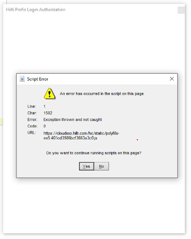

RISA Connection export to Profis not working.
Posted by  Mattalmost 3 years ago
We get a Profis lofin Authorization error Exceptop thrown. Cloussso.hilti
RISA Connection Integration,RISA

Hi Matt,
This issue is currently being worked on by RISA to be resolved on their end. I apologize for the inconvenience; however, the workaround at the moment is to export the loads to excel and import the excel file into PROFIS Engineering.
Regards,
Ashley
