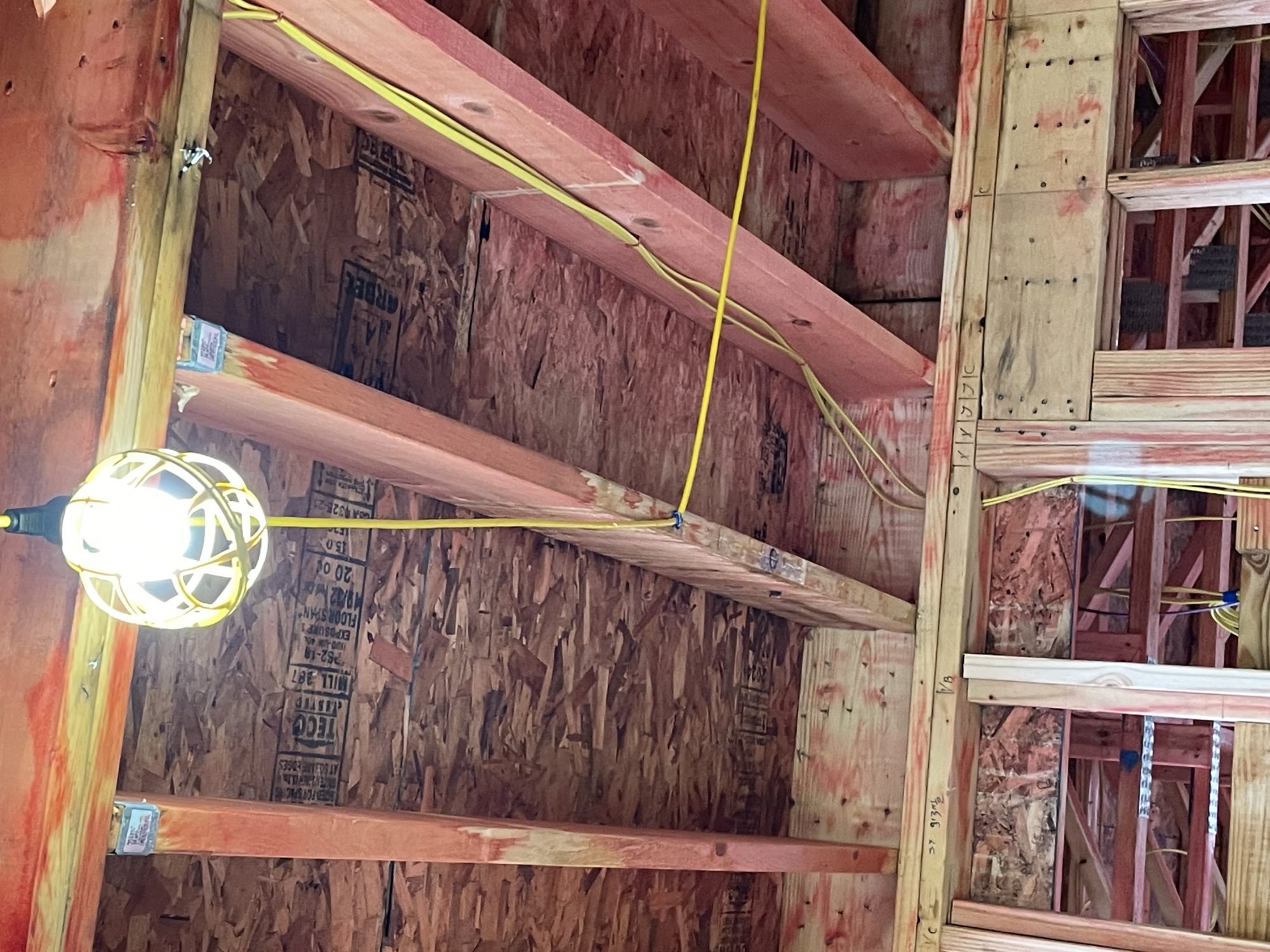

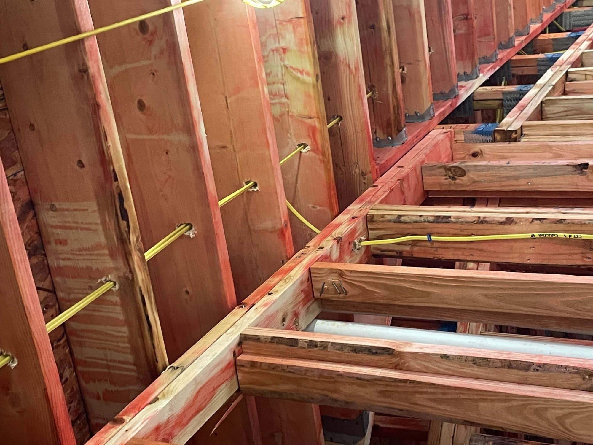

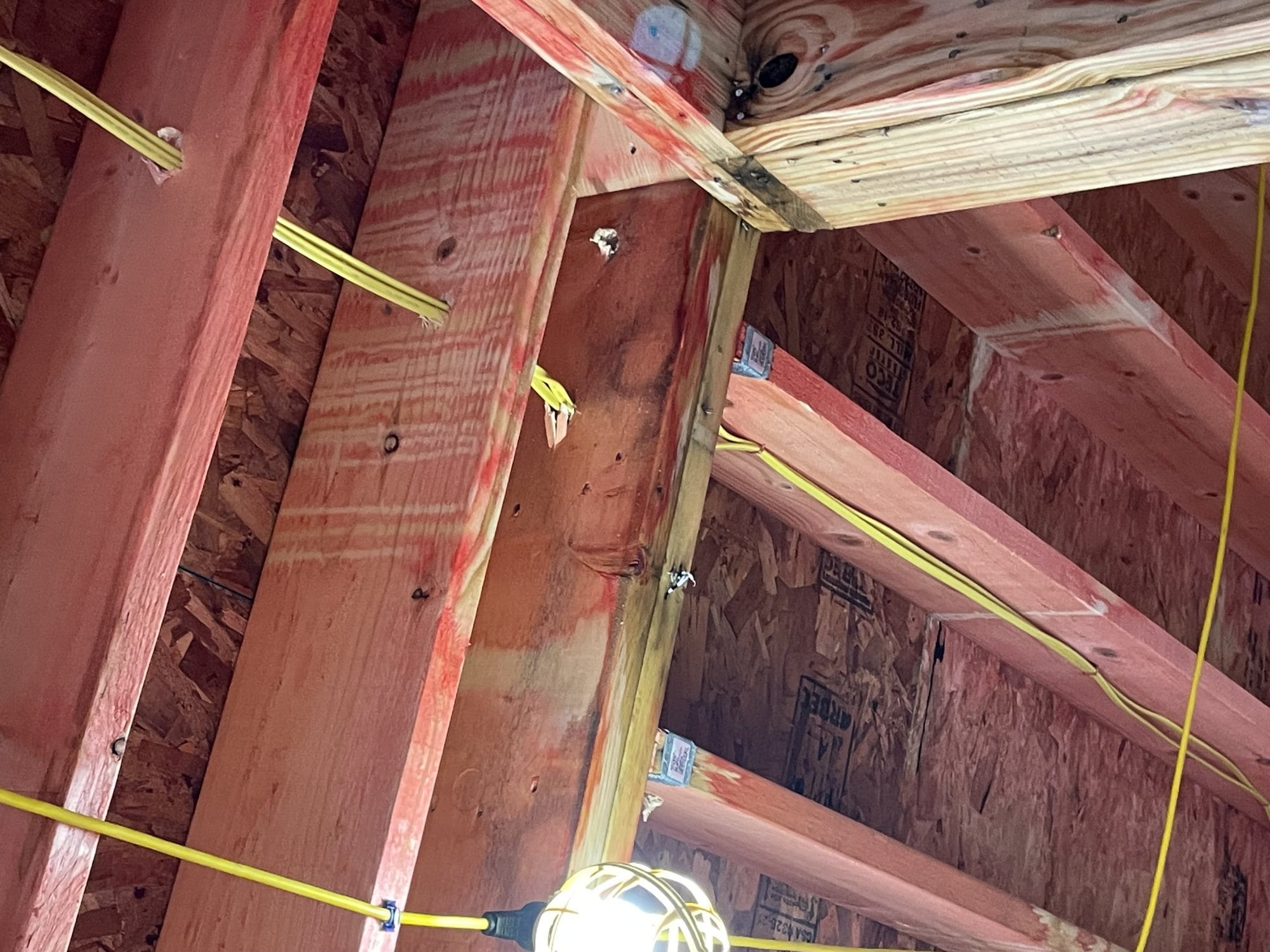

Attached are photos of ceiling beams on the 4th floor hall way. The electricians ran these wires for common space outlets in the interstitial space. Is this a code violation? Can I leave the wire and if need be just simply fire caulk any penetrations?
Fire,Caulk
1 Reply
Posted by Chase Hellanalmost 2 years ago
Hi Elda, Hilti is not able to comment on if this would be a code violation or not. You would need to work with your local AHJ to determine that. However, typically, penetrants completely within interstitial spaces are not required to be firestopped, only when they penetrant through the fire rated substrate. If you are needing this to be firestopped we can look at providing an Engineering Judgment for you. Please see below on how to submit.
