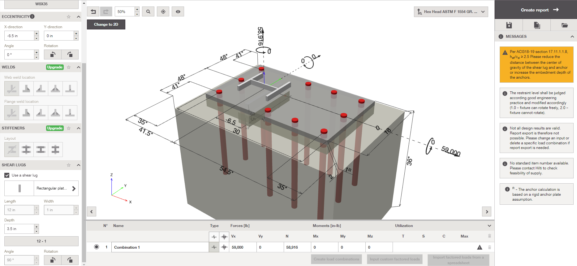

The Profis program has an error under the shear lug calculation per ACI 318-19 17.11.1.1.8 that does not go away even when the ACI requirement is satisfied. It also appears that the shear lug width is limited to 12" and the thickness is limited to 1". Why are these dimensions limited?
pIt looks like there is an error in your shear calculation. When I try to add a shear lug to my base plate it shows error

Hi Jeremy,
Thank you for your patience. Could you please share your PROFIS .pe file to hnatechnicalservices@hilti.com, and our team would be happy to assist further.

Help???? Hilti?????? has this ever been resolved?
Posted by IVAN MENZover 2 years ago
Was this error ever resolved? It's happening for me and I can't get it to go away
