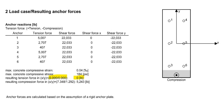

PROFIS 3.0.89 is reporting the resulting tension force of the anchor group as zero. (see attached)

Hi Louis,
For further assistance, please email your ".pe" file to hnatechnicalservices@hilti.com.
