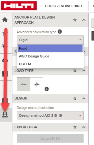

I did not find an option for utilizing reinforcement that is embedded with Hilti epoxy. I only saw options for Hilti steel rods. Does Hilti profis calculate capacities for this and if yes, how do I execute that option?

Hi Marcia,
If the design's anchor plate design approach is set to CBFEM, the software will filter out rebar as an anchor element option. Changing the baseplate design method to Rigid will allow you to select adhesive with rebar. See the screenshot below to see where to change your anchor plate settings.

Posted by Emily almost 4 years ago
Hilti Verified
Screenshot attached
