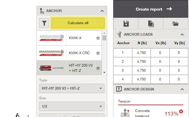

Hilti has a "Calculate All" button in PROFIS Engineering, which allows you to see the capacity for every anchor in the software. See the screenshot attached on where to find this option. If you are still having issues finding an anchor that works for your design, you may have to change some parameters such as anchor spacing, edge distance, etc.
