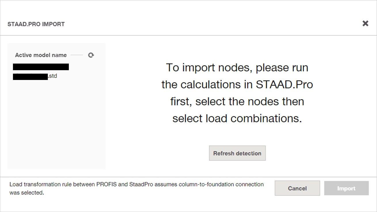

I have tried to import load combinations from STAAD.PRO to PROFIS ENGINEERING.
Hilti PROFIS Web Interface is also opened.
After running analysis in STAAD.Pro, the attached snapshot is shown on PORFIS and the load combinations are not able to be imported.
Of course, I selected nodes and load combinations as official training video shows.
Does this feature require any restrictions (type, number, etc.) or preferences?

Hi Takashi,
For the load combinations to transfer, you need to have your STAAD.Pro application, the PROFIS Web Interface, and PROFIS Engineering open. You will then select the nodes to transfer in STAAD.Pro. This will allow you to transfer the loads. Please see the linked tutorial video for additional information. https://ask.hilti.com/videos/hilti-profis-engineering-integration-with-staadpro/83sqyh
