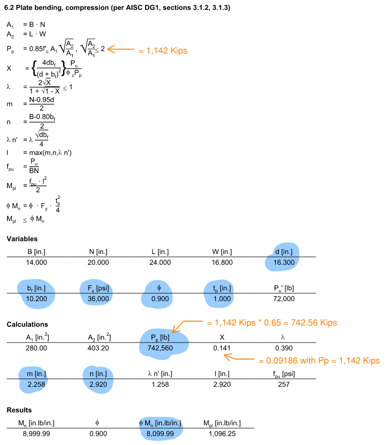

Posted by Murilo Santosover 4 years ago
Plate Bending - Pp problem
The Pp result does not match the equation. It seems that the result is already multiplied by phi (0.65). And this Pp is being multiplied again by 0.65 to calculate X.
compression,plate bending
1 Reply
Posted by Ashley Couronover 4 years ago
Hilti Verified
Hi Murilo,
For further assistance, please email your ".pe" file and PROFIS Engineering report to hnatechnicalservices@hilti.com.
Regards,
Ashley
1 comment on this reply
Hi Ashley, Ok, just sent the email. Thanks.
