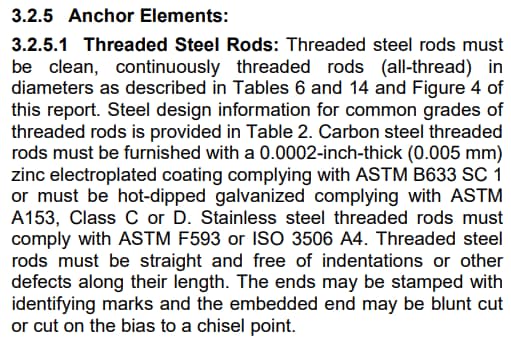

Threaded rods installed with Hilti adhesive anchors must comply with the specifications listed in the respective ESR for the adhesive. For example, with HIT-RE 500 V3 in ESR-3814, information on threaded rods can be found in Section 3.2.5.1. I have also included a snippet for your reference.
