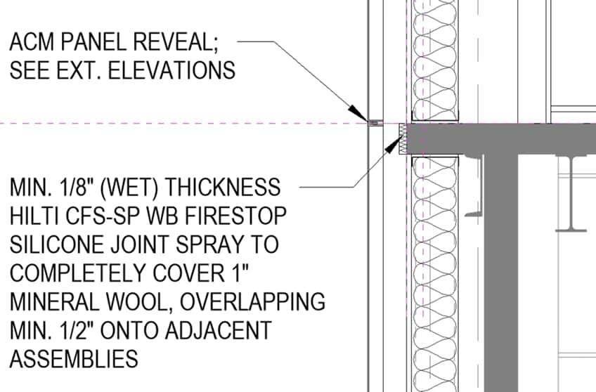

Would like to know if the 1" mineral wool is appropriate for this condition (see attached image)

Hello,
Thank you for reaching out to the Hilti Fire Protection Design Team to assist you with your firestop engineering needs.
We can address your application through an Engineering Judgment which will be a custom detail showing your exact application with the firestop components required to maintain the stated ratings.
