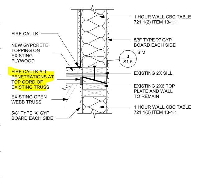

We have a conditions where the top of our open web steel joist is penetrating a 1 hour rated wall. I added a detail below. it is only the top flange that is interfering. Is it acceptable to just fire caulk around that penetration?
open steel joist penetration,Fire caulking at penetration's

Hello,
Thank you for reaching out to the Hilti Fire Protection Design Team to assist you with your firestop engineering needs.
We do not have any listed systems for the top of a steel joist penetrating the gypsum wall; however, we can address your application through an Engineering Judgment, which will be a custom detail showing your exact application with the firestop components required to maintain the stated ratings.
