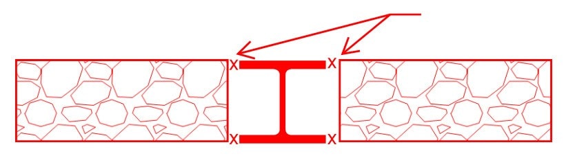

I am looking for a 1 hr rated solution for a steel to CMU safeing condition
Shallow firestop system,minimal movement

David,
We do not have any listed systems for this application. As such, this will need to be an engineering judgment (EJ), which will be a detail showing your exact application with the firestop components to maintain the stated ratings.
Please see attached for Hilti engineering judgment request form. Please fill out the form, SAVE AS, and email the completed form with any additional details (such as the sketch you attached) to usfirestopeng@hilti.com
