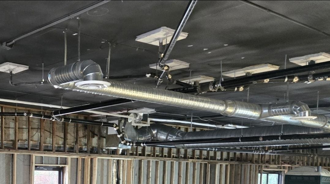

I need to provide a cut sheet to my inspector for fire stopping installation to cast Iron penetrations in concrete slab ceilings

Good morning. Thank you
I don't have access to the top side of the hollow core floor. We are in a restoration project to pre existing pipes and concrete slab. No ability to sleeve the penetrants. I believe the closest assembly I've found is F-B-1035. I've requested an EJ to include double layer 5/8's GWB to close the annular gap and fill with FS One max
