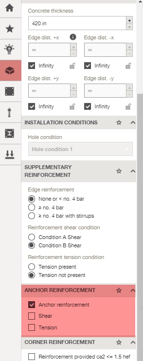

Location of Reinforcement tab?
Posted by James Potterfalmost 4 years ago
Where is the Reinforcement tab as described in 8.1.2.5 of the user manual? I only have the Supplementary Reinforcement tab shown.

Posted by Emily almost 4 years ago
Hilti Verified
Hi James,
Please see this previous Ask Hilti response. See the image for where to locate the anchor reinforcement settings when using a cast-in place anchor.
For additional assistance, please contact hnatechnicalservices@hilti.com.
Cordially,
Emily
