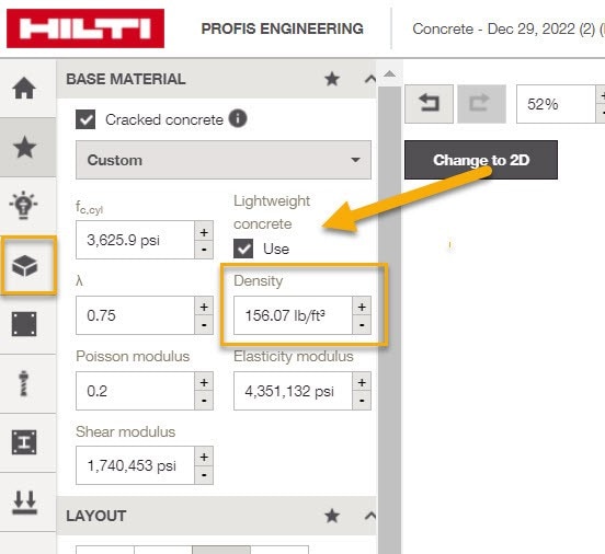

Is there an option to select lightweight concrete in profis? I have semi lightweight concrete with a 120 pcf density and anchoring a plate
light weight concrete,We’re using this material for fixing the threaded anchor in the concrete foundation

Hi David,
Please reference the attached screenshot to see where this lightweight concrete feature is available in PROFIS Engineering.
