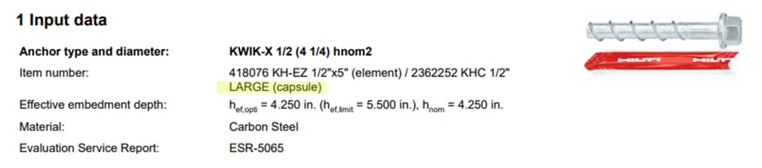

Does Profis tell the designer which capsule size to use for the Kwik-X dual action anchor? And is this something that should be specified on engineered drawings? Or do the contractors know what capsule to use based on the nominal embed depth specified?

Hi Matt,
Based on the diameter and embedment depth of the Kwik-X dual action anchor, PROFIS will automatically generate which capsule size to use once the report is created. An example report with the Kwik-X dual anchor and capsule size can be found in the snippet attached.
Regards,
Ashley
