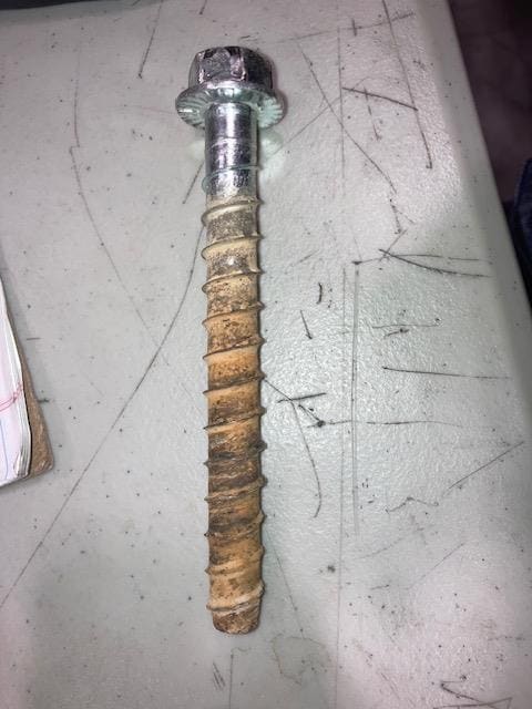

KH-EZ screw anchors
How to remove anchors that are rusted into cement floor that have been anchored for several years?
anchor,rust,cement
1 Reply
Posted by Ashley Couronalmost 3 years ago
Hilti Verified
Hi Alphonse,
Typically, anchors will be removed using a core drill with a larger size diameter than the anchor that is installed. If you would like to discuss this application further, feel free to email our team at hnatechnicalservices@hilti.com or give us a call at 877-749-6337.
