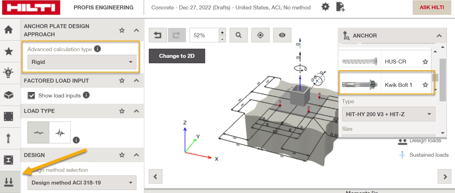

Hi, I am trying to evaluate KB1 in specific job and I can't find it available in PROFIS anchor list

Hi Meirett,
The Kwik Bolt 1 may not display in your available anchors because of the design settings in PROFIS. For example: KB 1 is not applicable to the CBFEM calculation type but will appear if you switch to Rigid design.
