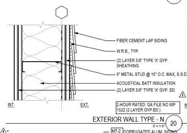

We are constructing a rated blind wall on a project in Berkeley, CA. The wall is being constructed in segments and slide into place. The inspector is requesting a listed detail assembly for the horizontal and vertical joints on the blind wall side where we can't fire tape the joints. I've attached a photo showing the walls being installed in sections. I've also attached a typical detail of the wall assembly.
Do you have any products that can be applied within the stud bay at the joint locations to address this concern?

Hello Mark, unfortunately we do not have any details to address the joints within the stud cavities based on your condition. This is more of a constructability issue than a firestop one. Please feel free to give us a call for any further questions at 1 (800) 879-8000. Thank you.

Hello Mark, you can also send questions or an EJ request to our HCP platform and submit your complete conditions on what you have and what you need, but firestop is never meant to replace mud and tape. I've provided details on how to submit a request below.
