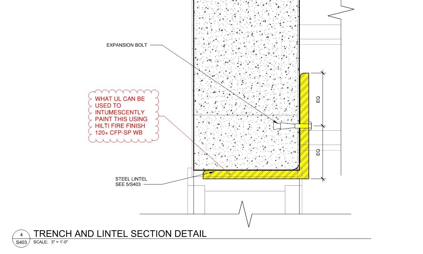

Is there a UL that can be used to intumescently paint a steel lintel using Fire Finish 120 CFP-SP WB?
Posted by Adam Bannisterover 3 years ago
Hi there, is there a UL that can be used with Fire Finish 120 CFP-SP WB Intumescent paint on a steel lintel above an opening? I am using UL Y634 and UL N640 for coverage of my steel beams and HSS columns but am not sure if these can be used on the steel lintel as it is an angle (L12X12X1).

Good afternoon Adam,
The thickness required for the Steel Angles can be calculated with the attached calculator based on the UL Y663 listing. If needed an Engineering Judgement (EJ) which will be a custom detail showing your exact application could be created for this application as well. See below for a link to register and request an EJ if needed:
