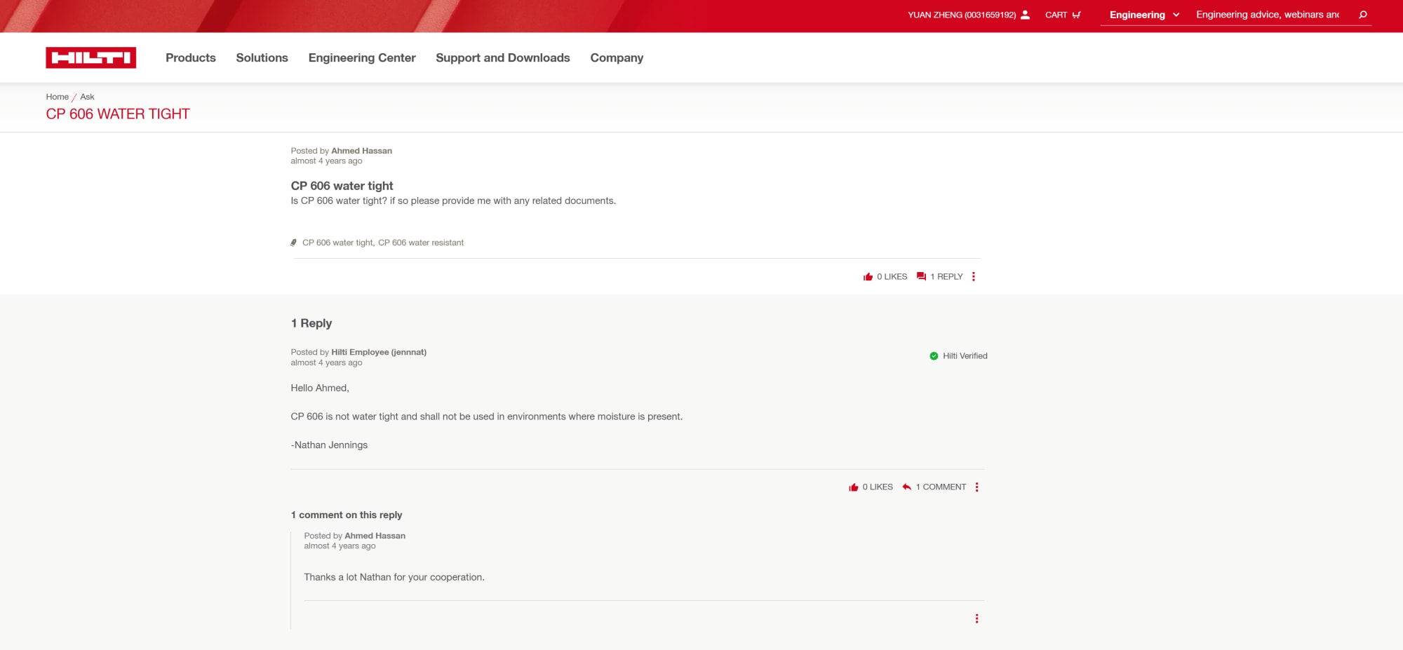

Is Hilti CP 606 Firestop acrylic sealant water tight? Please see attached picture. But latest product data sheet indicates that CP 606 Firestop acrylic sealant is water tight. Is there W-Rated firestop sealants available?

Hi Yuan, W rating is part of a UL listed system and would need to be come from that. To my knowledge there is no UL Listed systems that would allow CP 606 to achieve a W rating as of today. This may change in the future with more testing.
Thank you,
Chase Hellan
Sr. Fire Protection Engineer
