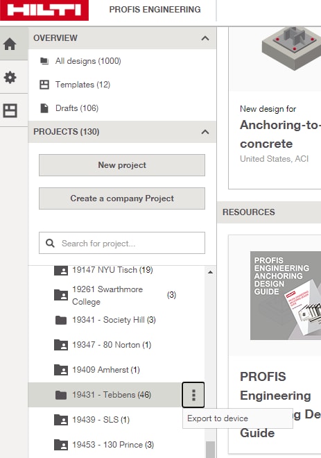

Include People within Projects
Posted by Mark Prikazskyalmost 3 years ago
We have a company project and looking to add another engineer to gain access to a project
Profis online access,Hilit Profis
1 Reply
Posted by Ashley Couronalmost 3 years ago
Hilti Verified
Hi Mark,
A company project is shared through the cloud with everyone on the PROFIS Engineering premium license automatically. It would thus pop up on the home page of everyone using the PROFIS premium license. To be added to the company project, the user must be added to the premium license by contacting the admin and having them add the additional user to the license.
If you would like to know how many seats your license has, please contact our PROFIS Engineering sales team at PESales.USTeam@hilti.com.
Regards,
Ashley
