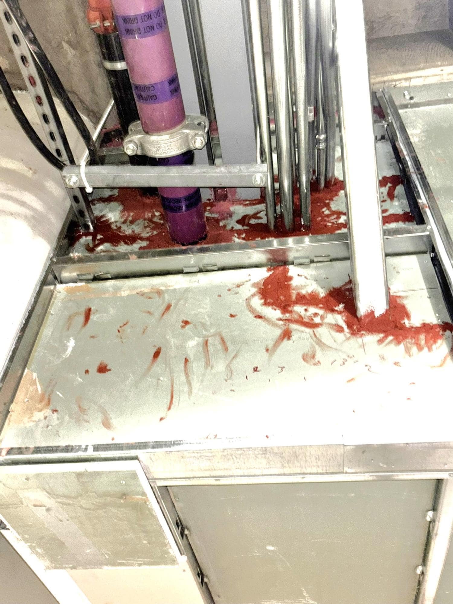

I want Hilti to look at the attached photo and render an opinion.
Posted by sftoolgirlabout 1 year ago
I would like to know what Hilti thinks of this installation of its products and whether Hilti would think that these penetrations are actually going to stop the spread of smoke and fire. There is no annular space no rigid support on both sides and I think they just stuffed red sealant in there. I have lots more photos. Hilti products were submitted for this project and I wonder if Hilti should go take a look at what was installed. Also are your products warranted if installed by people not trained to install them?

Hello,
For questions on proper installation of firestop, I would reach out to the firestop inspector for this job or your authority having jurisdiction. Hilti would be happy to have one of our field team members walk the site with you to address any concerns as well. Please call the customer service number (listed below) for help identifying your closest field representative based on the job location.
If you have any questions, please reach out to our customer service team at 1-800-879-8000 (US) or 1-800-363-4458 (Canada) for assistance.
