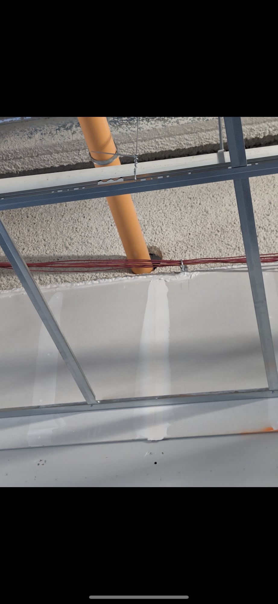

I need a EJ on a 1-1/2" CPVC pipe running thru a solid I. beam with a 2 hour fire rating.
