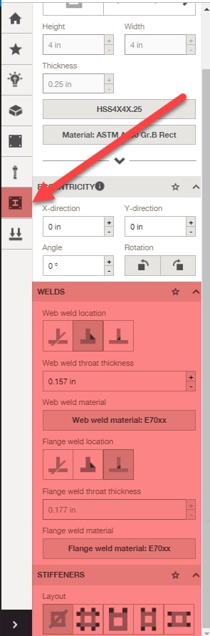

I upgraded the Profis to premium but could not find how the baseplate and stiffener design works. Would you help me in this regard?

Hi Mahmoud,
To locate where you can change weld and stiffener settings, ensure the anchor plate design approach is using "CBFEM" then see the attached annotated screenshot. Adding welds or stiffeners will impact the Component Based Finite Element Modeling (CBFEM) results. For more information on CBFEM, see this Ask Hilti Article.
