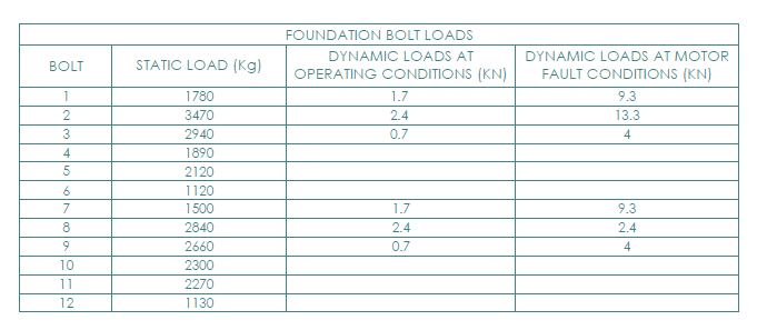

I am working on Project where it requires to perform Anchor analysis based on Compressor vendor provided data. See attached screenshot. These data reflets anchor loading. Would be able to help me how to use PROFIS software to specify Static and Dynamic load on Bolt # 2 from table attached ?

Currently, dynamic loads are unable to be input into PROFIS Engineering due to there being no test standards for dynamic loading in North America. If you have further questions regarding dynamic loading, please reach out to hnatechnicalservices@hilti.com.
