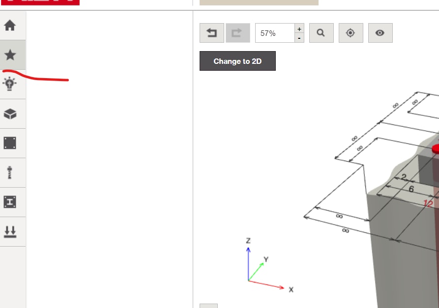

How to set "My favorite Inputs" as default?
I removed the " My Favorite Inputs" accidentally. Now this tab is totally blank. How I can set it as default? Any suggestions will be greatly appreciated. Thanks,

Hi April,
To favorite a parameter option so that it saves to the favorites tab, select the star next to the parameter option name within another tab. The favorites tab incorporates the parameter options from the other tabs (base material, anchor plate, anchor, etc.) into a single tab – the my favorites inputs (star) tab; however, it does not default or save to the specific values or options you change your parameters to. PROFIS Engineering will continue to use its own default parameters.
To further assist you, please email your inquiry to hnatechnicalservices@hilti.com.
