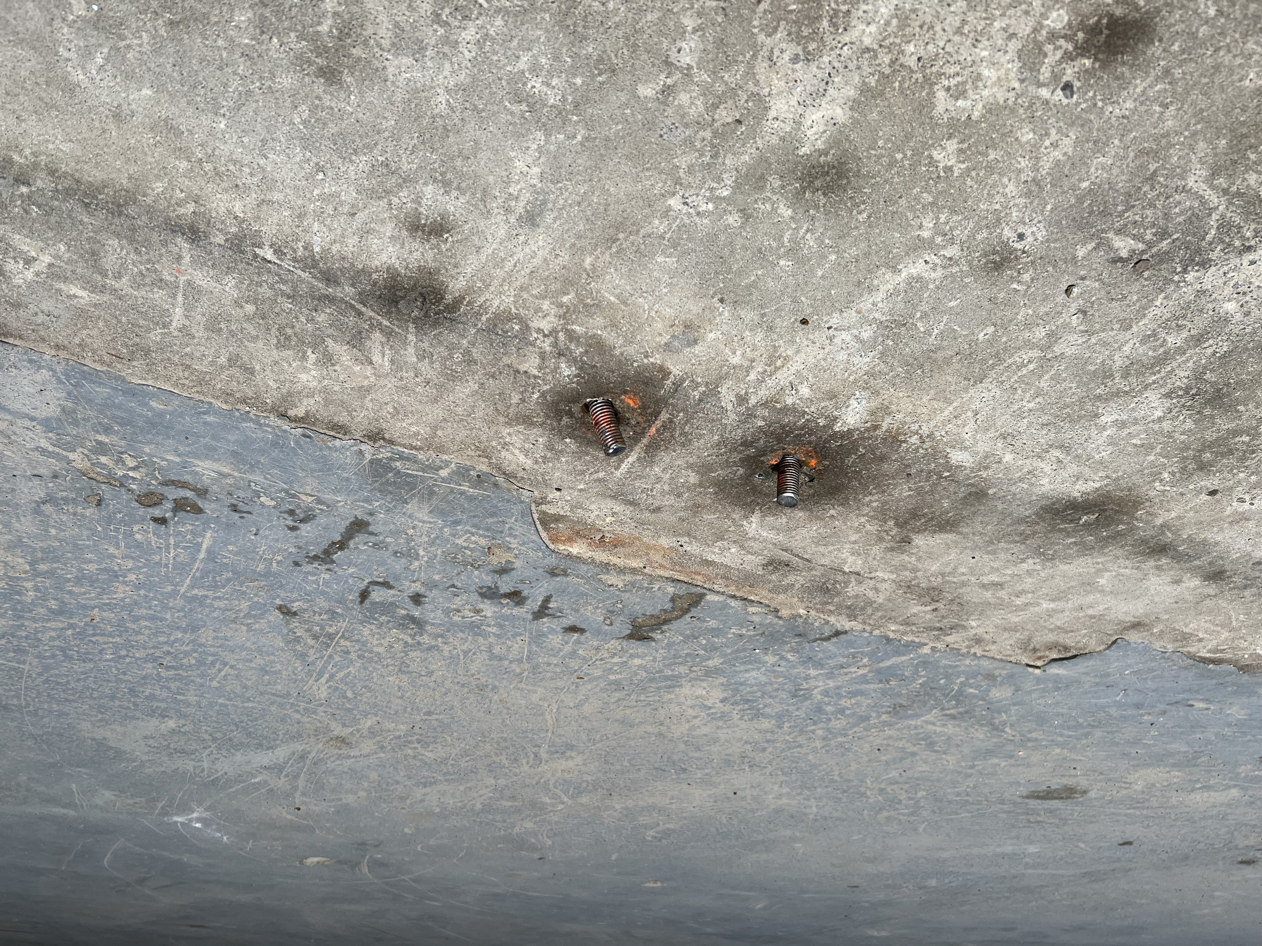

We have some Hilti, 5/8" diameter, HAS-R 304SS, chemical anchors installed in a concrete floor slab which have been driven over with a scissors lift and bent. What is the best method to repair these anchors? Can they be straighten?

Hilti does not have any guidance on how to straighten a bent rod. The anchor could be cored out and replaced with a new, straight threaded rod however this is a decision up to the engineer of record.
