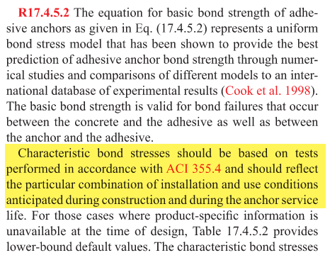

Hi Sarah,
The characteristic bond strengths are determined from testing per the acceptance criteria AC308 and ACI 355.4, so different manufactures will have different values. Please see the snip from ACI 318-14 R17.4.5.2 attached where it mentions these values should come from testing.
