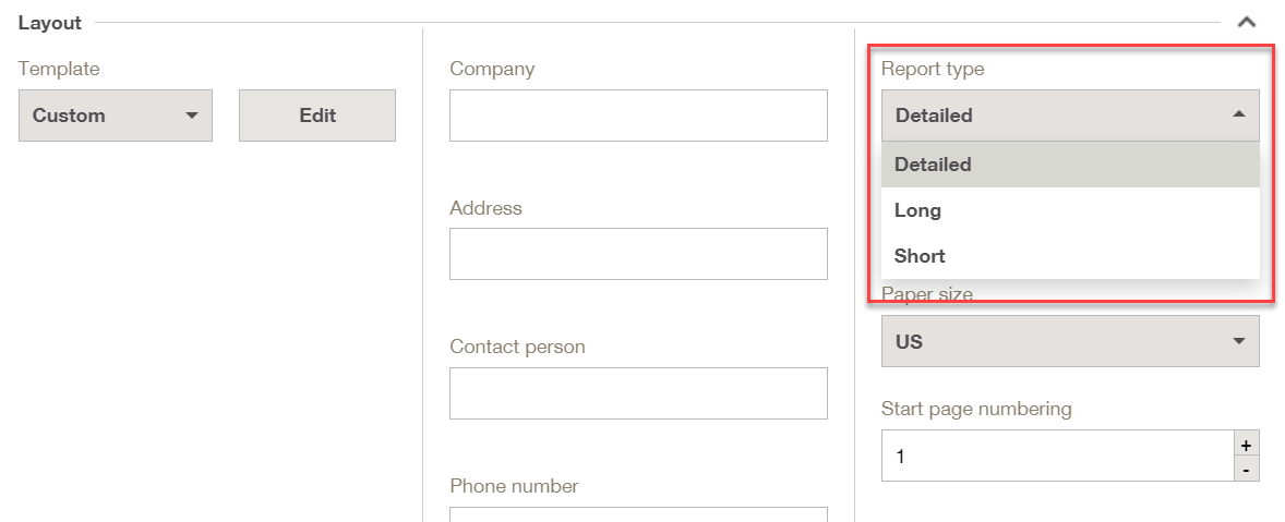

How do you show Base plate calculation on Report ?
Posted by Jesse Navarreteover 3 years ago

Hi Jesse,
To show the base plate analysis results, the design method has to be CBFEM or AISC Design Guide 1. If you are designing with these, the other issue could be the report type you are generating. You will want to make sure you are selecting either a detailed or long report (see attached screenshot). If you need more assistance, please feel free to reach out to Hilti's engineering team at hnatechnicalservices@hilti.com or 877-749-6337.
