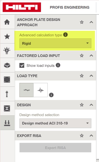

Hi David,
To change the anchor plate design approach in PROFIS Engineering, please refer to the attached screenshot.
Regards,
Ashley
Profis engineering software
