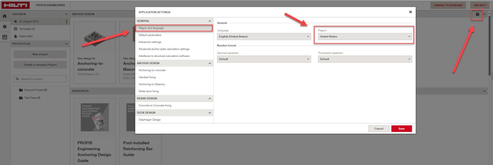

We work on projects outside the US and need to do anchor calcs with metric fasteners.

Hi Doug,
For designs outside of North America, you may change your region in the settings menu on the PROFIS Engineering homepage (please see attached screenshot). Selecting a different region will change the list of available products in design files.
For additional assistance, please reach out to hnatechnicalservices@hilti.com or give us a call at 877-749-6337.
