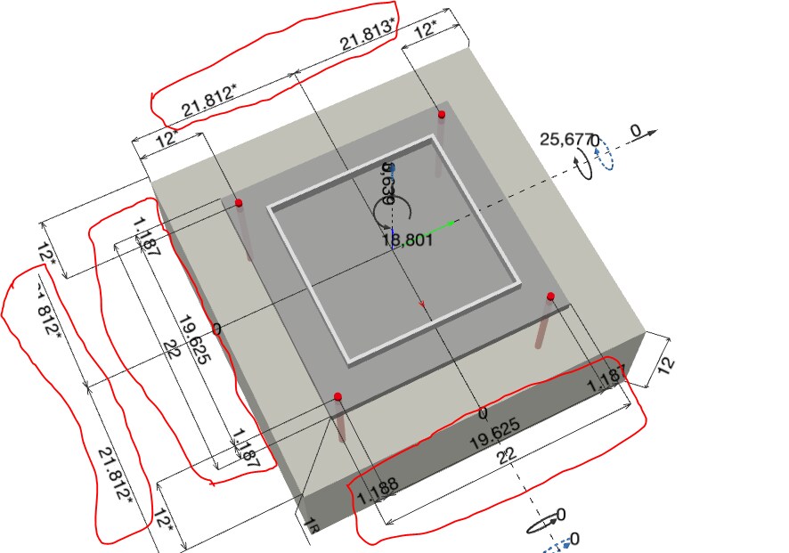

I created a file and created a square baseplate, and on one side profis did the math right and on one side it founded incorrectly and I can't fix it because this terrible program is always trying to figure out what I want and do math for me. Is there a way to turn off the "automatically do incorrect math" feature so I can put in the correct dimensions?

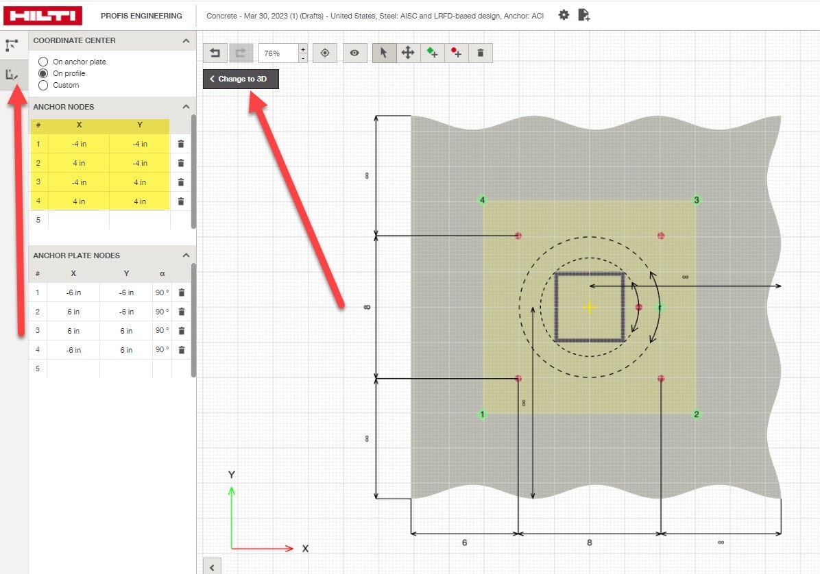

Hi Ryan,
To assist with anchor placement, open the design and select the "change to 2D" button. The 2nd tab on the far left hand side on 2D view allows users to input anchor node locations with x and y coordinates. See the attached image. For further assistance, please email hnatechnicalservices@hilti.com.
