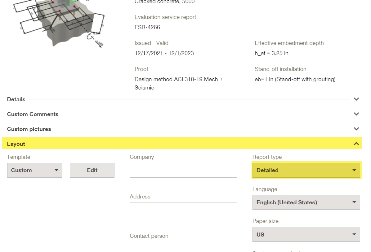

How do I change the calculation report to long format instead of short format in Hilti Profis Engineering
I'm checking for anchor concrete breakout, and I would like to see the "long" report format, but the default is "short" format
Anchor Breakout Long Report Format,Not short report

Hi Dana,
After you click "create report" you will click on the layout drop down. In that drop down, there should be an option to change the type of report generated. I included a screenshot for reference. If you are still having issues, please reach out to Hilti's engineers at hnatechnicalservices@hilti.com and attach the .pe file.
