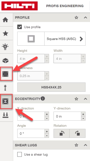

I am designing a suspended platform system I have a 1" thick base plate with a 5" attachment plate where I am going to attach my cable for the platform. How do you change the attachment plate?

Are you designing with PROFIS Engineering? If so, baseplate profiles may be adjusted in the "Profiles" tab of PROFIS Engineering. Additionally, baseplate settings may be adjusted in the "Anchor Plate" tab.
