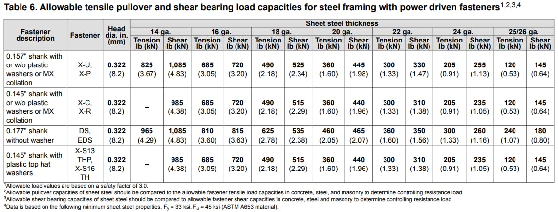

The product data for the X-U fasteners include allowable shear and tension values for sheet steel. The ICC-ES Report (ESR-2269) does not include this table. Is there documentation that includes this table, besides the product data, that DSA would find acceptable?

Thank you for reaching out. Documentation on the use of X-U fasteners into sheet steel is found in the Product Technical Guide. Pullover is not evaluated in the ICC-ESR. For further questions, please contact hnatechnicalservices@hilti.com.
