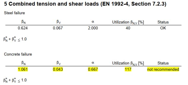

When supplementary reinforcement is to take up tension loads only, according to EN 1992-4, NRd,c is not included in the design resistance checking. HILTI PROFIS seems still checking Concrete failure, βN and βV. My question is, how is the βN calculated?
š‘š‘…š‘‘,š‘ - design resistance in case of concrete cone failure under tension load.
